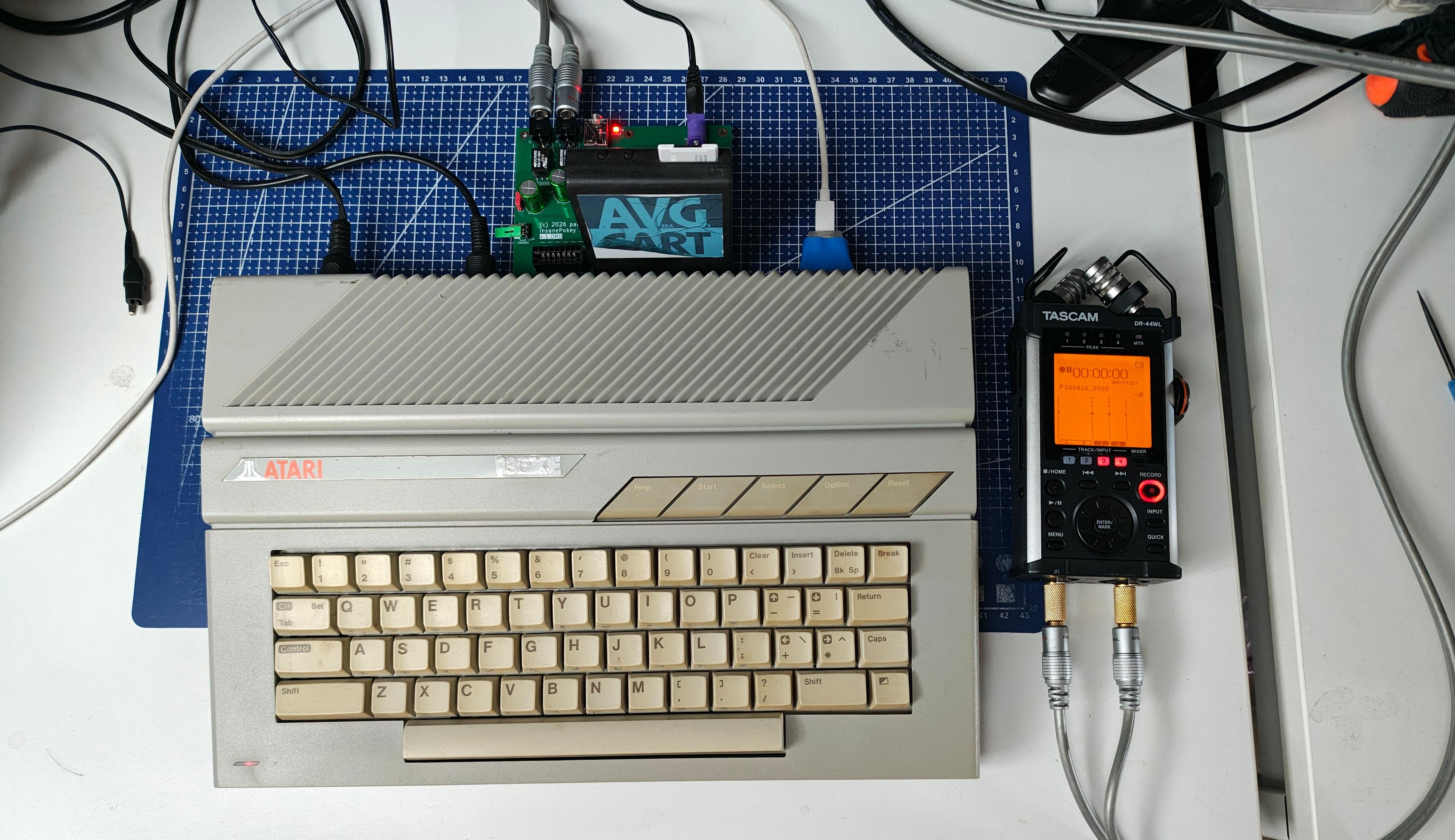

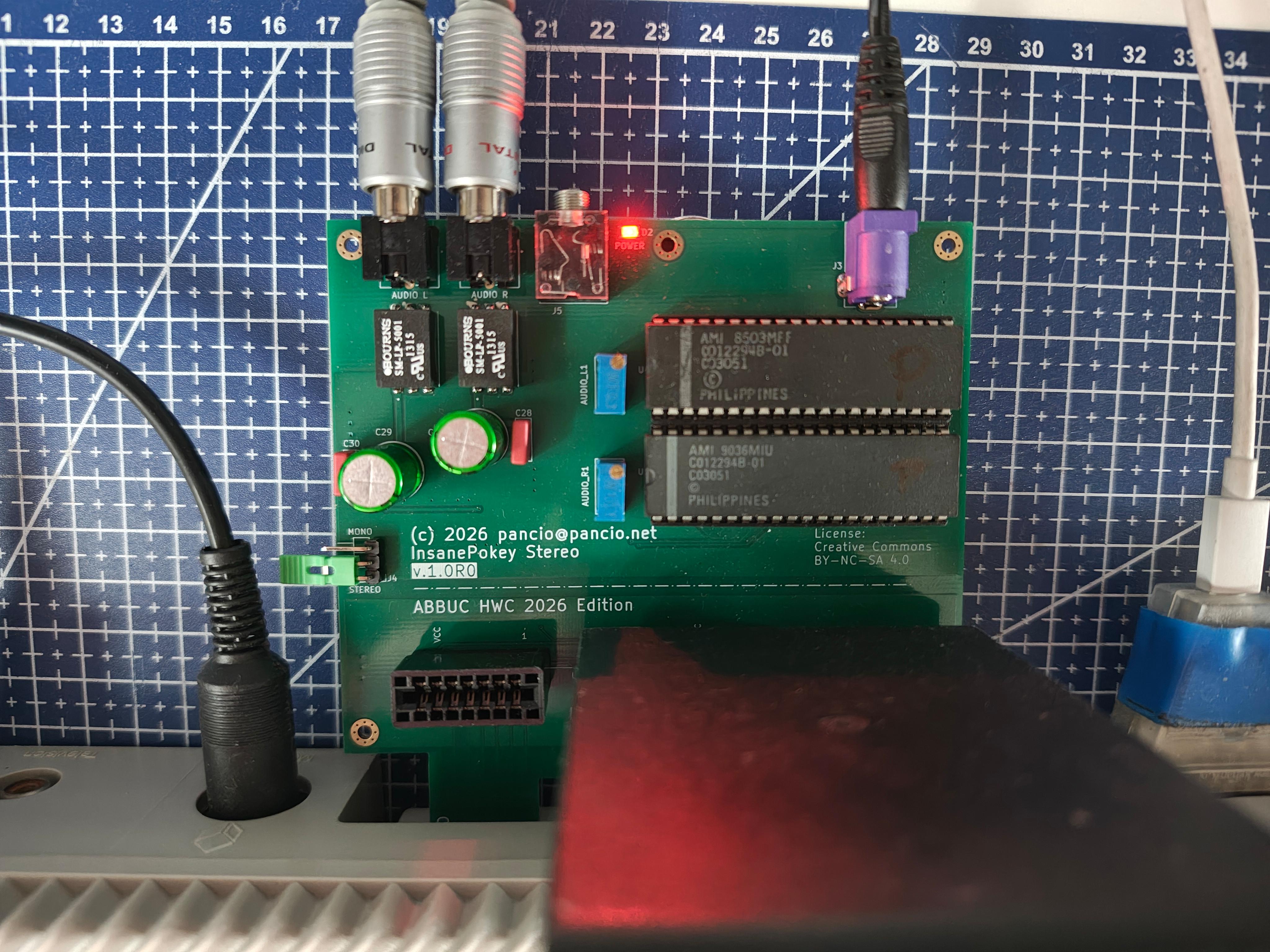

Hi Everyone!
InsanePokey – a gateway to new sound quality!
I'd like to introduce you to a somewhat controversial yet intriguing device that could easily be called crazy stereo, intended for purists of the sound of our favorite sound chip.
What isn't InsanePokey? Before answering this question, let me present some facts... There are several different stereo audio expansions available on the market with two POKEY chips. Most of them are mounted inside the Atari computer and generate an audio signal of varying degrees of quality. The problem is that the audio path in these expansions is exposed to all kinds of interference, primarily from the Atari's power supply. The quality of our sound is also affected by all kinds of interference from switching circuits (TTLs) and other main computer systems – especially ANTIC and its memory refresh cycles. This problem can be minimized using special filters tuned to specific frequencies, and some expansions do, but this is very difficult and often requires a customized approach for each expansion. InsanePokey is free of these defects.
So what is InsanePokey and how does it differ from other extensions? InsanePokey is a simple stereo audio extension containing two POKEY chips, connected to our computer's CART/ECI port. This is the main difference, but not the most important! The most important characteristic of InsanePokey is that our POKEY chips are galvanically isolated from our computer – this applies to both the power supply and all signal lines. This is crucial for sound quality, as virtually no electrical interference enters the audio path, as there is no single electrical connection between the sound-producing component and the computer. But that's not all! The final sound-shaping stage uses a power amplifier with very good parameters and adjustable gain for each audio channel. Additionally, the audio output uses specialized audio transformers that isolate and isolate the InsanePokey's ground from our external audio amplifier. It's this separation, separate power supply, and the use of audio transformers that make InsanePokey so different from other expansions...
Who is InsanePokey for? InsanePokey was created in response to problems our colleagues had with other POKEY Stereo modules, and they decided to record the world's first vinyl with Atari music. While InsaneStereo wasn't used in this album, I hope it will be used on the next vinyl release :-) That's why Atari music lovers are the target audience! Nothing will give you the same experience as InsanePokey! One more thing should be said: unfortunately, this isn't a cheap interface. The components used are rather high-end... for example, a gold-plated PCB, insulators, audiophile-grade capacitors and transformers. Additionally, you need two additional POKEY chips (the one in the Atari must be in the Atari!), so this solution is more for those geeks who don't accept compromise :-)
Here are the InsanePokey specifications: - external stereo audio extension with a mono/stereo switch that doesn't require any intervention in the Atari computer, - fully electrical isolation of all control lines and power supply, - fully isolation of the output stage from the external audio amplifier (elimination of ground loops), - autonomous power supply for the audio circuits (separators, POKEYs, amplifier) ​​within a 6-12V range, - independent gain control on both audio channels, - the design allows for the connection of additional expansions – a CART/ECI extension. - headphones socket,
As I wrote a while ago, if InsanePokey Stereo plays, I'll submit the project to this year's ABBUC HWC. It's an official submission! And I'm incredibly happy about that :-)
For those interested in more details... about the features and launching of the interface, check out this thread: https://abbuc.de/forum/viewtopic.php?f=3&t=4908

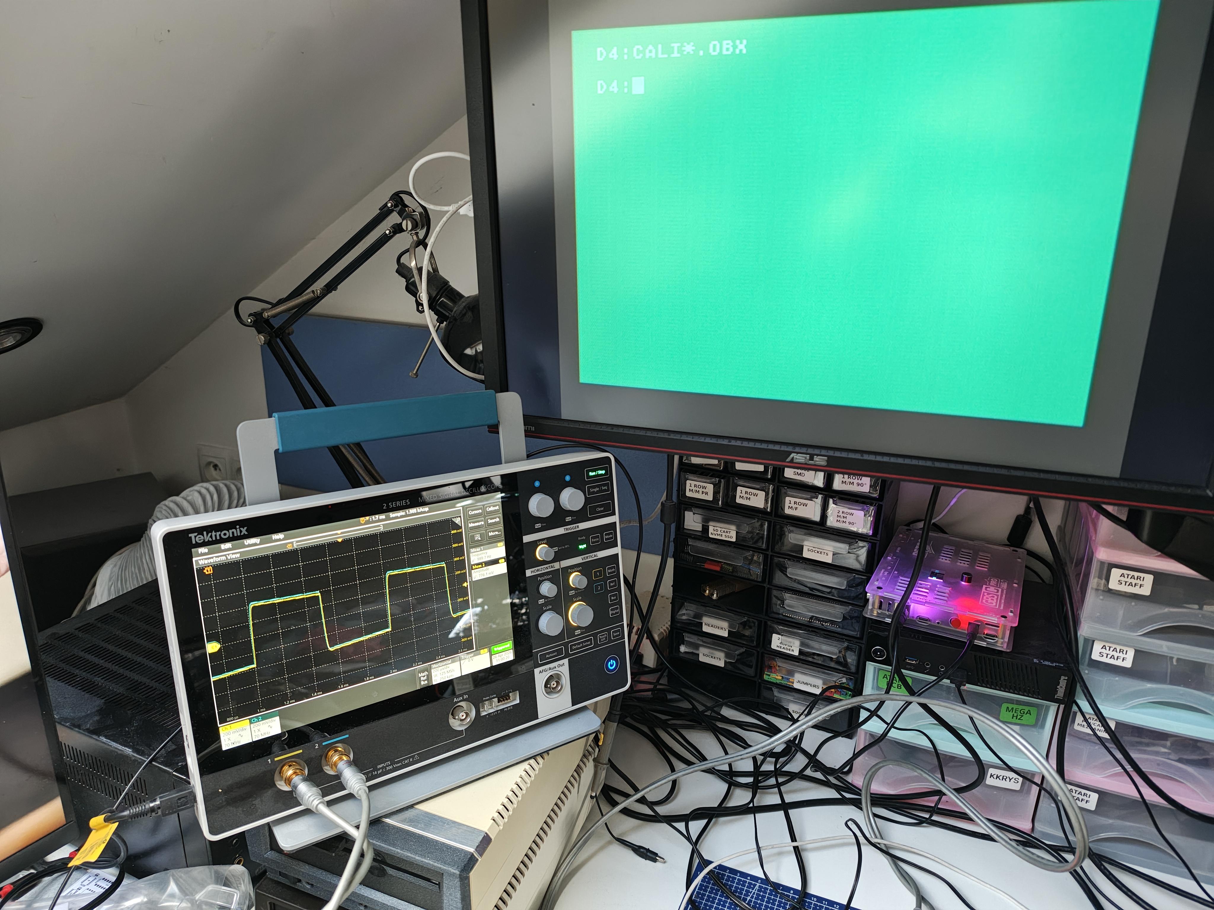

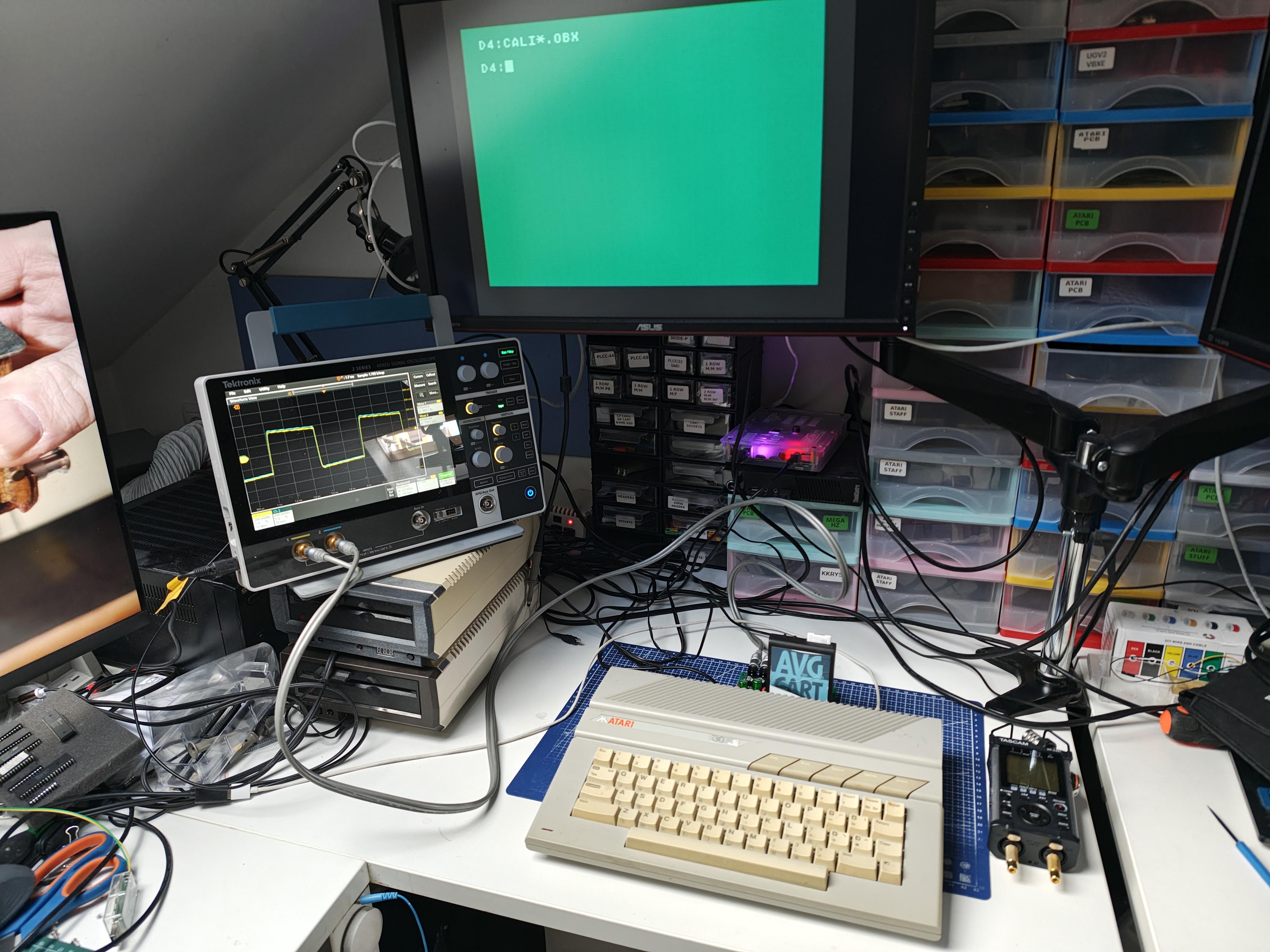

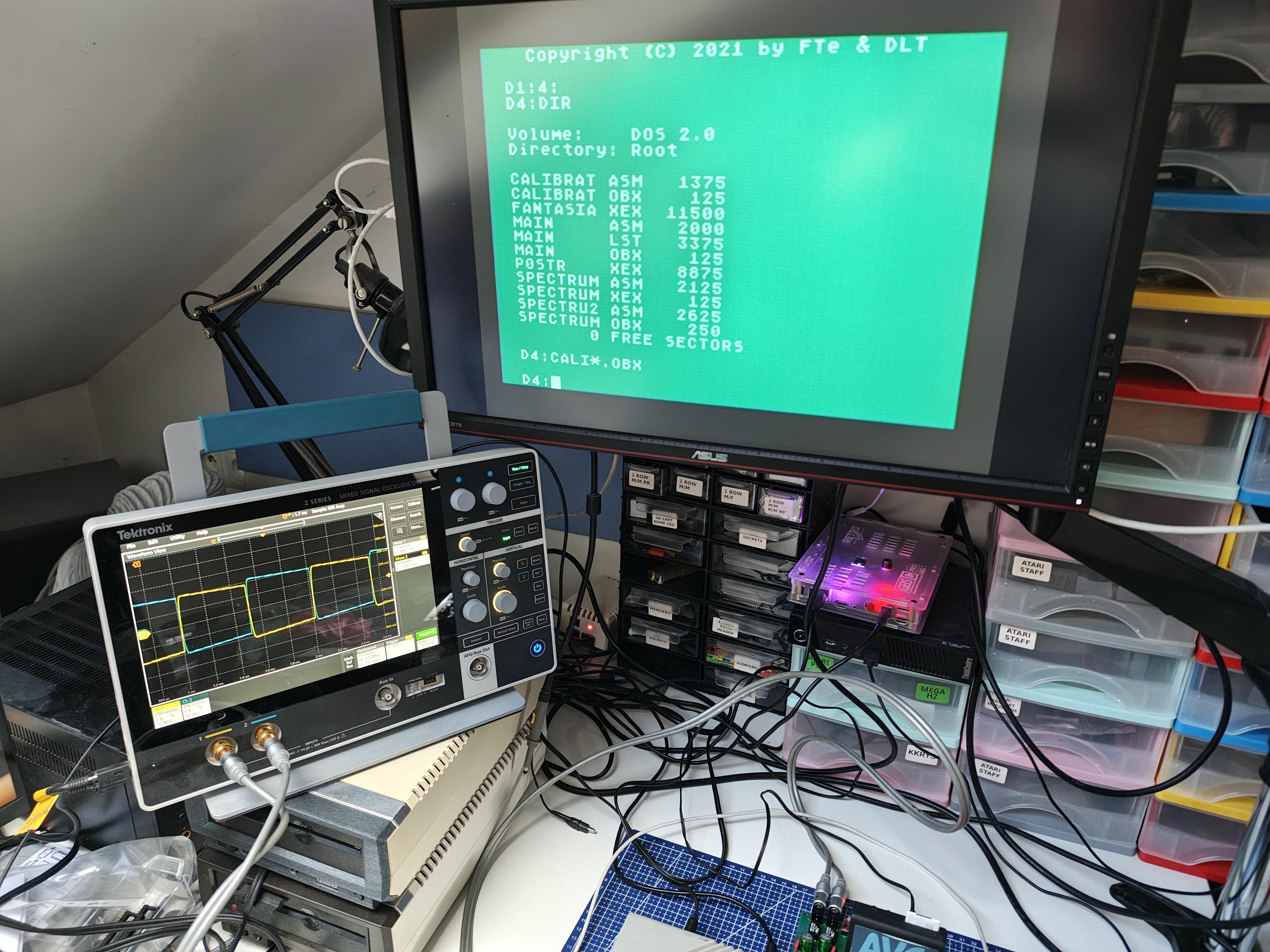

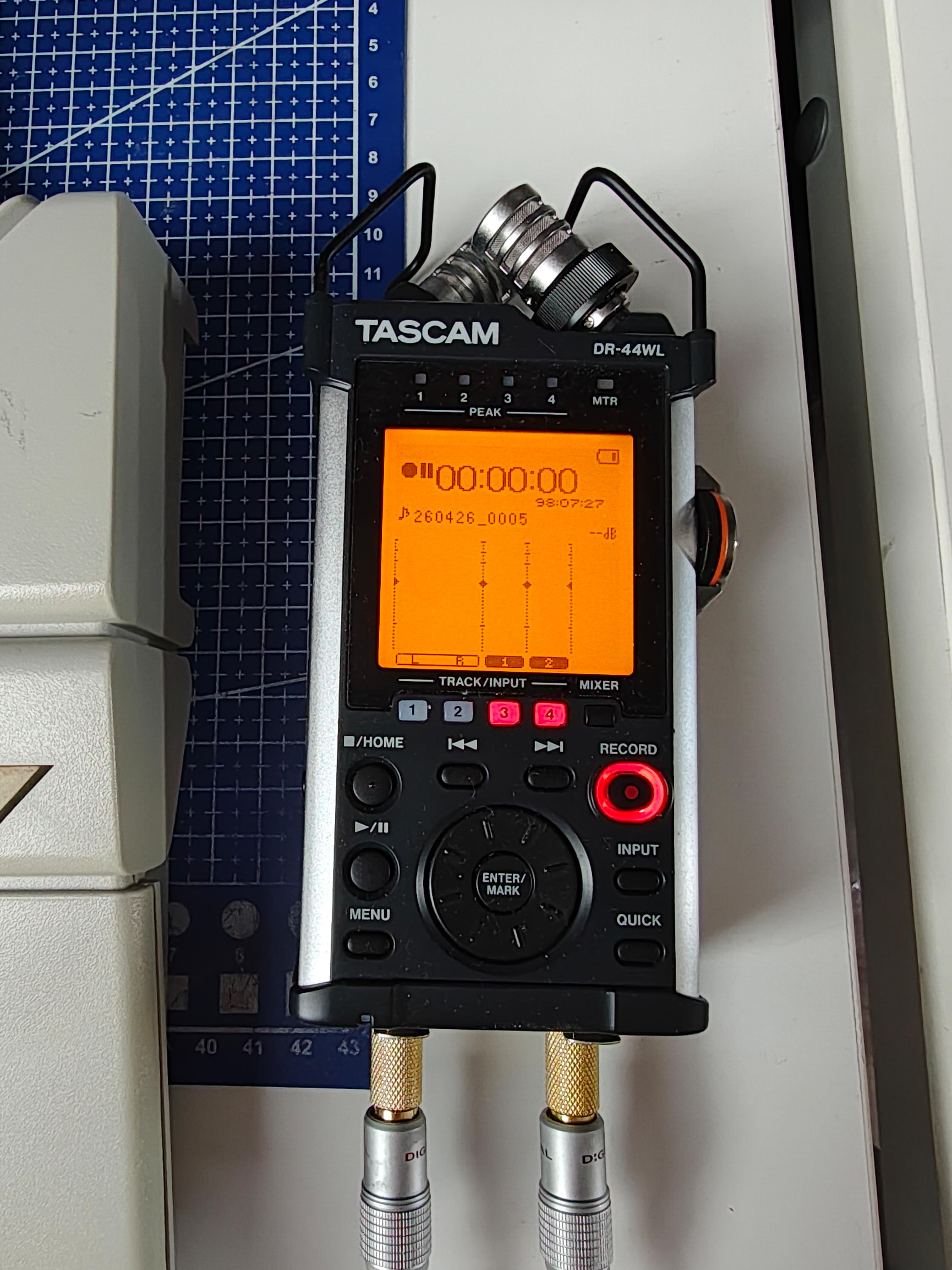

Below are some working photos during prototype testing. You may also to hear sample on YT - unfortunately I cannot ass WAV to this forum...
https://youtu.be/qWMIHuk1c-o
Have fun and vote to my project! pancio

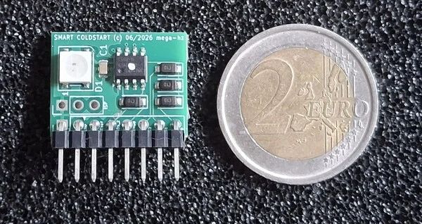

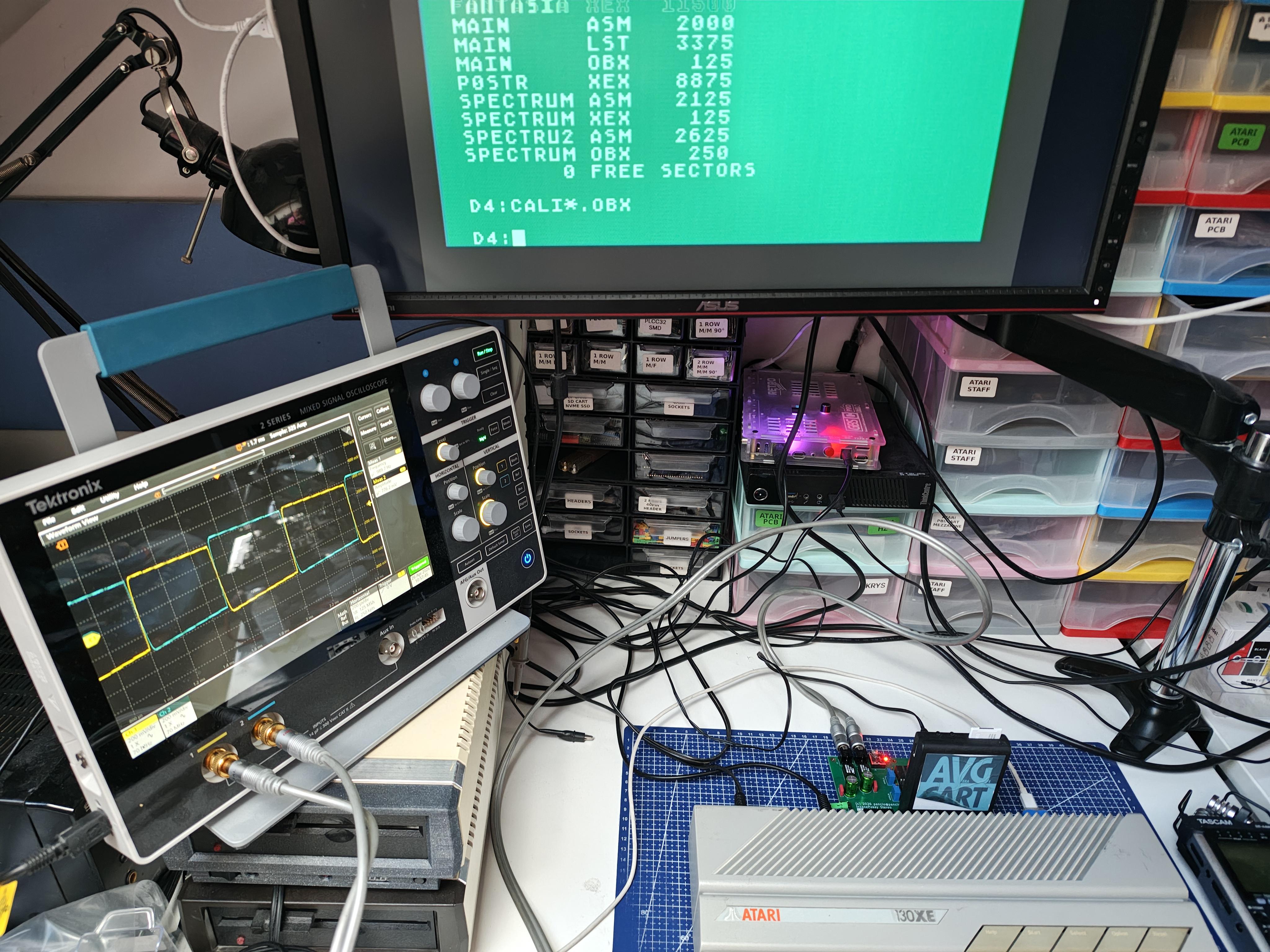

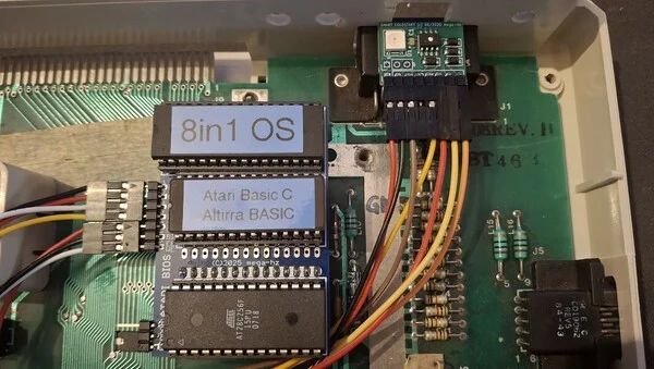

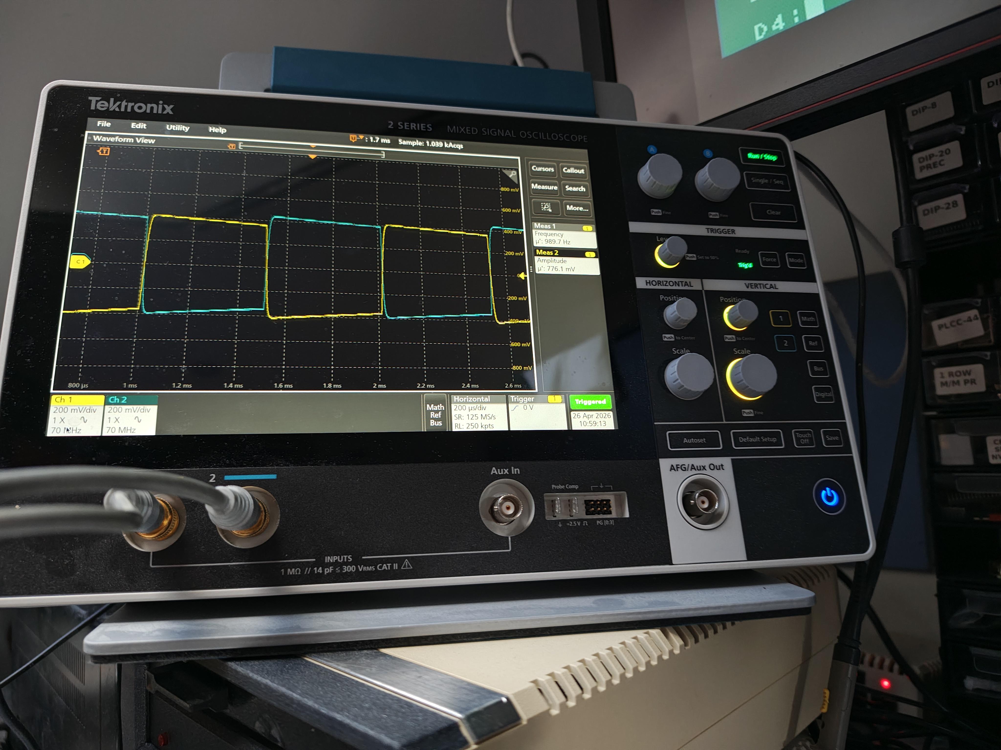

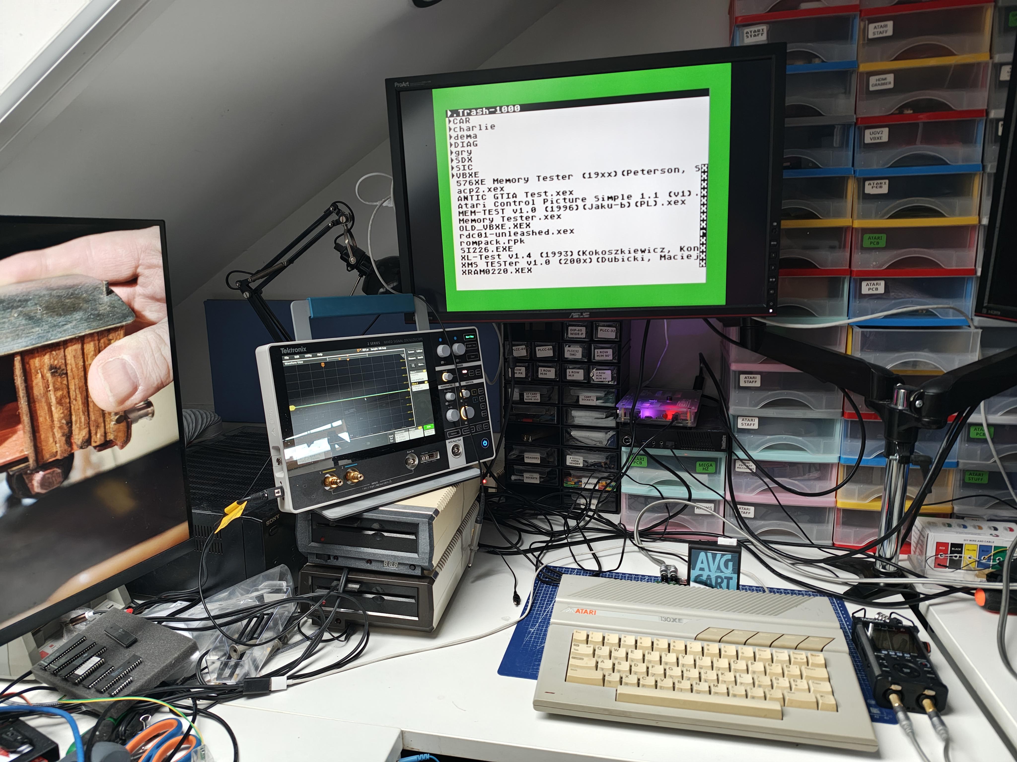

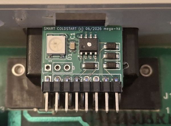

Smart-Reset+
Kalt oder Warmstart abhängig davon wie lange Reset gedrückt wurde
Ich möchte euch ein weiteres Projekt vorstellen, das am ABBUC-Hardware-Wettbewerb 2026 teilnimmt: „SMART-RESET+“
Entwickler von „Smart-Reset+“ ist das ABBUC-Mitglied „mega-hz“. Da er mit dem Lötkolben besser umgehen kann als mit der Feder, hat er mich gebeten, den ganzen Schreibkram zu erledigen.

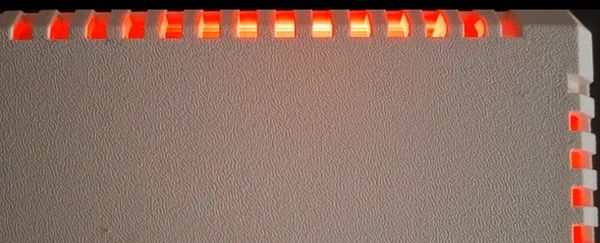

Smart-Reset+ ist eine kleine Hardware-Erweiterung (nur 21 mm x 17 mm) für den Atari XL und XE, mit der man über den originalen Reset-Knopf zwischen einem Warmstart und einem Kaltstart wählen kann. Die Auswahl hängt davon ab, wie lange der Knopf gedrückt wird. Ein kurzer Druck löst wie gewohnt einen Warmstart aus. Wird der Reset-Knopf länger als 2 Sekunden gedrückt gehalten, wird ein Kaltstart durchgeführt. Eine Änderung des Betriebssystem-ROMs ist nicht erforderlich. Es sind lediglich vier Kabelverbindungen zwischen der Erweiterungsplatine und der Hauptplatine erforderlich. Die Platine ist so klein, dass sie problemlos mit doppelseitigem Klebeband am SIO-Sockel befestigt werden kann. Das integrierte LED-Modul leuchtet dann hell durch die Lüftungsschlitze.
Wie das „+“ im Namen schon andeutet, bietet „Smart-Reset+“ noch mehr Funktionen:
Bei Systemen mit einer integrierten Mini-BIOS-Erweiterung von mega-hz lässt sich das BIOS-Menü ganz einfach durch Gedrückthalten der Reset-Taste für mindestens 4 Sekunden aufrufen. Das knifflige Manöver, bei dem Start, Select, Option und Reset gleichzeitig gedrückt werden müssen, entfällt. Um diese Option zu nutzen, müssen lediglich drei zusätzliche Verbindungen zwischen der Smart-Reset+-Platine und dem Atari hergestellt werden.
Optional bietet „Smart-Reset+“ die Möglichkeit, das Reset-Verhalten eines XL-Computers auf XE-Computern zu emulieren, mehr dazu später an anderer Stelle.
Hier ist eine Übersicht über alle Funktionen, die „Smart-Reset+“ bietet:
• Warmstart durch kurzes Drücken der Taste
• Kaltstart durch langes Drücken der Taste (2 Sekunden oder länger)
• Optional: Aufruf des Mini-BIOS-Menüs durch sehr langes Drücken der Taste (4 Sekunden oder länger)
• Anzeige der ausgewählten Reset-Funktion über die integrierte mehrfarbige LED (gut sichtbar durch den Lüftungsschlitz)
• Optional: Anpassung des XL-Reset-Verhaltens auf XE-Computern
• Software-Update der „Smart-Reset+“-Firmware über einen USB-TTL-Konverter mithilfe eines Skripts
Technische Umsetzung:
Die Schaltung basiert auf einer Idee, die bereits vor fast 30 Jahren von Peter Bee und Erwin Reuß in der Ausgabe 04/88 des Compy-Shop-Magazins veröffentlicht wurde. Das Grundkonzept besteht darin, das Betriebssystem durch direkte Manipulation des RD5-Signals am MMU-Pin 8 glauben zu lassen, dass ein Modul in den Modulschacht gesteckt wurde, wodurch beim folgenden Reset anstelle des üblichen Warm-Starts ein Kalt-Start erzwungen wird. Die technische Umsetzung ist jedoch völlig anders. Die ursprüngliche Schaltung erforderte einen zusätzlichen Taster für den Kaltstart. Der Reset-Taster wurde über einen 74LS123 (monostabiler Multivibrator) überwacht und war bei XE-Modellen nur eingeschränkt einsetzbar.
Der Smart-Reset+ verfolgt einen völlig anderen und deutlich moderneren Ansatz: Ein ATtiny402-Mikrocontroller überwacht den Zustand des Reset-Tasters direkt am Eingang des Schmitt-Triggers (XL) oder des NE555 (XE). Sobald die Reset-Taste gedrückt wird, misst der Mikrocontroller die Zeit, die bis zum Loslassen der Taste vergeht, und leitet dann einen Warm- oder Kaltstart ein oder ruft, falls vorhanden, das Mini-BIOS-Menü auf. Ein integriertes LED-Modul zeigt anhand der Farbe an, welche Funktion gerade ausgeführt wird, je nachdem, wie lange die RESET-Taste gedrückt gehalten wird:
bis zu 2 Sekunden – grün – regulärer Warmstart
2 bis 4 Sekunden – rot – Kaltstart
4 Sekunden oder länger – blau – Aufruf des Mini-BIOS-Menüs

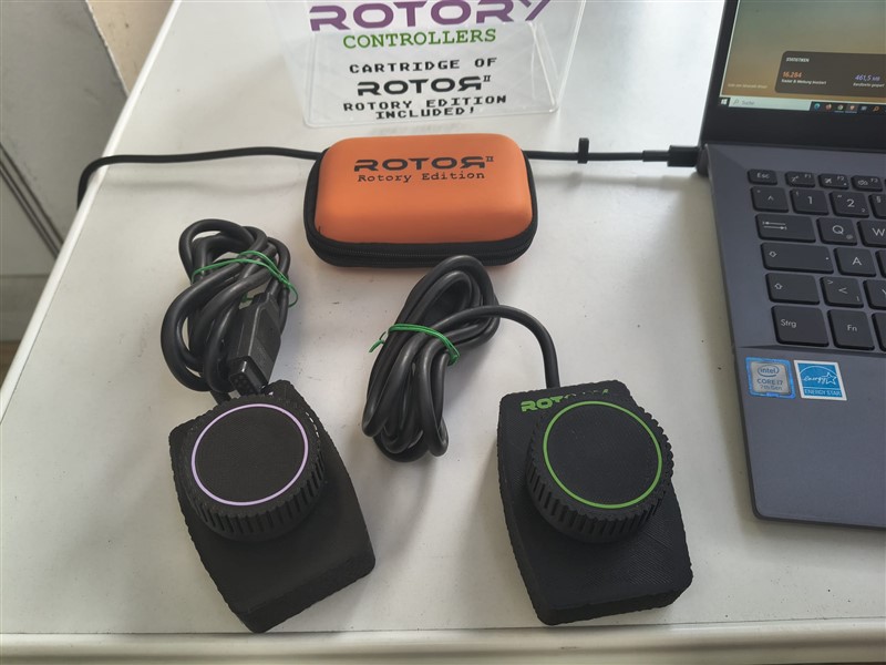

Einreichung / Beitrag zum AHC 2026 von Freddy Offenga (F#Ready) & Fred Meijer
Die ROTORY Controller:
Die Idee dahinter:

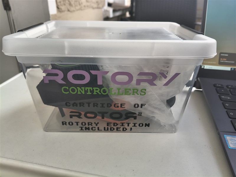

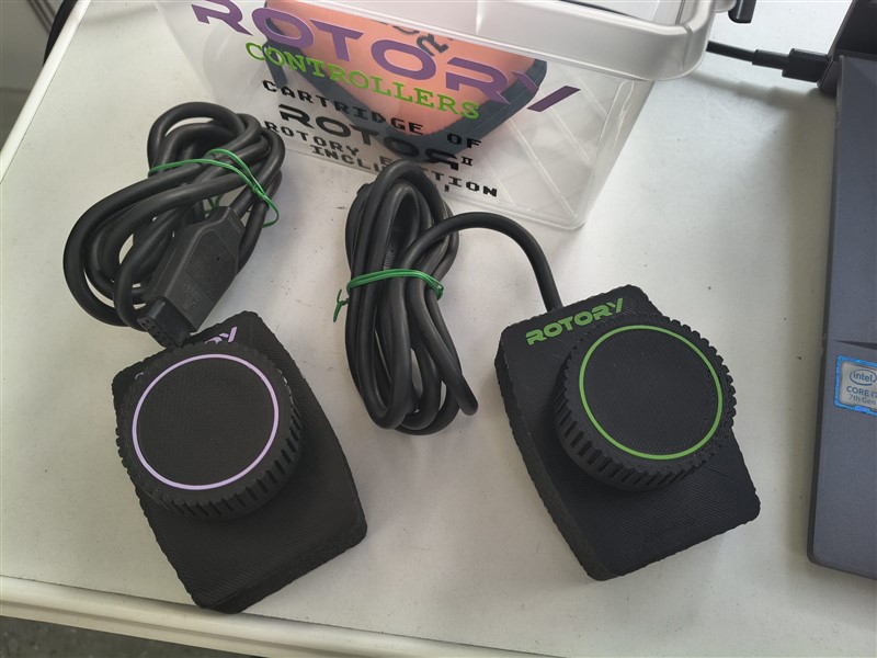

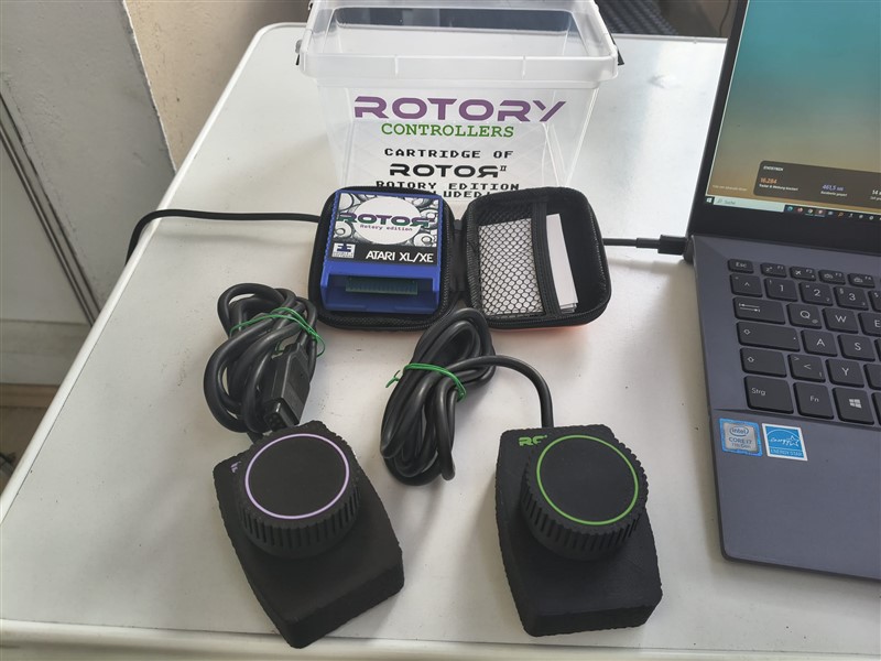

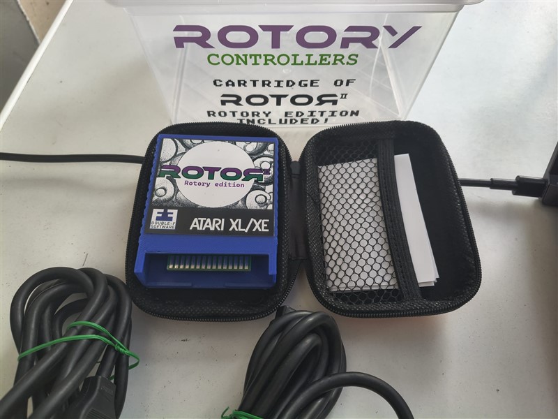

Freddy und Fred haben für das Spiel ROTOR zwei neue Controller entwickelt, die wie eine einzelne Mausachse funktionieren und eine höhere Auflösung als die Atari-Controller haben.
Die neuen ROTORY- Controller lassen sich sehr einfach nachbauen und können im Prinzip auch füre andere Spiele und Anwendungen (mit kleinen Anpassungen) genutzt werden.
Freddy & Fred waren so nett und haben mir ein komplettes Testexemplar (1x sehr schöne Transportbox, 2x Controller samt Game-Modul und Manual in einer schicken Tasche zugesandt!
Danke nochmal dafür! Alles macht einen sehr professionellen und hochwertigen Eindruck!
Gefällt mir sehr gut!
Ein paar Bilder folgen später noch (da es hier mit dem Upload leider immer noch etwas hakelt (Error 500 usw.)

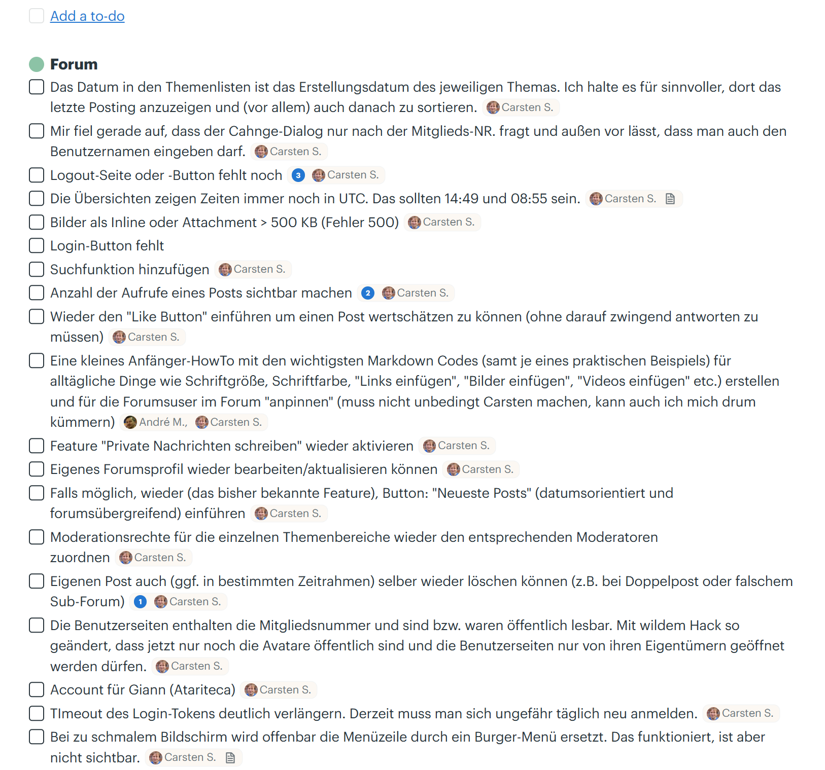

Kann man diesen Beitrag wieder oben anpinnen?
Das Problem ist, dass die Beiträge anscheinend stur nach Entstehungsdatum sortiert werden und dann an dieser Stelle verbleiben, auch wenn ein neuer Beitrag erschienen ist.
Ja, das mit der Sortierung ist ein wenig lästig. Gruß Wolfgang
Hi Olix, Hi Wolfgang,
ja das Thema steht mit auf der (großen) ToDo Liste! Wenn die Ferien um sind, will sich Carsten (mit Unterstützung) nochmal intensiv an das Feintuning des Forums ransetzen!
Die bisherige ToDo habe ich mal im Mitgliederbereich gepostet:
-> ToDo Forum:
